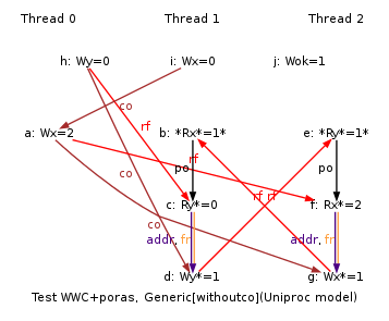

Test WWC+poras
Executions for behaviour: "1:r1=1 ; 2:r1=1 ; ok=1 ; x=1"
Executions for behaviour: "1:r1=1 ; 2:r1=1 ; ok=1 ; x=2"
PPC WWC+poras
"RfePR PodRWRA RfeAR PodRWRA WseAP"
Cycle=RfeAR PodRWRA WseAP RfePR PodRWRA
Prefetch=0:x=F,2:x=W
Com=Rf Rf Ws
Orig=RfePR PodRWRA RfeAR PodRWRA WseAP
{ ok=1;
0:r2=x;
1:r2=x; 1:r4=y; 1:r6=ok;
2:r2=y; 2:r4=x; 2:r6=ok;
 P0           | P1               | P2               ;
 li r1,2      | lwarx r1,r0,r2   | lwarx r1,r0,r2   ;
 stw r1,0(r2) | li r3,1          | li r3,1          ;
              | lwarx %sta,r0,r4 | lwarx %sta,r0,r4 ;
              | stwcx. r3,r0,r4  | stwcx. r3,r0,r4  ;
              | bne  Fail1       | bne  Fail2       ;
              | b   Exit1        | b   Exit2        ;
              | Fail1:           | Fail2:           ;
              | li r5,0          | li r5,0          ;
              | stw r5,0(r6)     | stw r5,0(r6)     ;
              | Exit1:           | Exit2:           ;
Observed
    1:r1=1; 2:r1=1; ok=1; x=1;
and 1:r1=1; 2:r1=1; ok=1; x=2;
