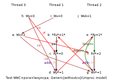

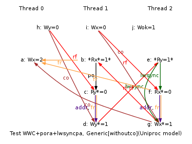

Test WWC+pora+lwsyncpa
Executions for behaviour: "1:r1=1 ; 2:r1=1 ; ok=1 ; x=1"
Executions for behaviour: "1:r1=1 ; 2:r1=1 ; ok=1 ; x=2"

Observed
    1:r1=1; 2:r1=1; ok=1; x=1;
and 1:r1=1; 2:r1=1; ok=1; x=2;
