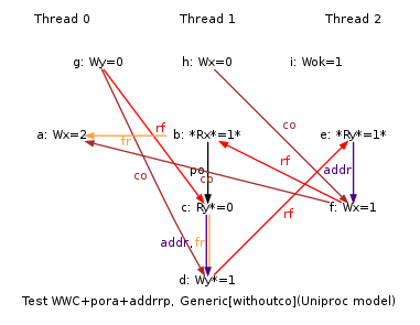

Test WWC+pora+addrrp
Executions for behaviour: "1:r1=1 ; 2:r1=1 ; ok=1 ; x=1"
Executions for behaviour: "1:r1=1 ; 2:r1=1 ; ok=1 ; x=2"
PPC WWC+pora+addrrp
"RfePR PodRWRA RfeAR DpAddrdWRP Wse"
Cycle=RfeAR DpAddrdWRP Wse RfePR PodRWRA
Prefetch=0:x=F,2:x=W
Com=Rf Rf Ws
Orig=RfePR PodRWRA RfeAR DpAddrdWRP Wse
{ ok=1;
0:r2=x;
1:r2=x; 1:r4=y; 1:r6=ok;
2:r2=y; 2:r5=x;
 P0           | P1               | P2             ;
 li r1,2      | lwarx r1,r0,r2   | lwarx r1,r0,r2 ;
 stw r1,0(r2) | li r3,1          | xor r3,r1,r1   ;
              | lwarx %sta,r0,r4 | li r4,1        ;
              | stwcx. r3,r0,r4  | stwx r4,r3,r5  ;
              | bne  Fail1       |                ;
              | b   Exit1        |                ;
              | Fail1:           |                ;
              | li r5,0          |                ;
              | stw r5,0(r6)     |                ;
              | Exit1:           |                ;
Observed
    1:r1=1; 2:r1=1; ok=1; x=1;
and 1:r1=1; 2:r1=1; ok=1; x=2;
