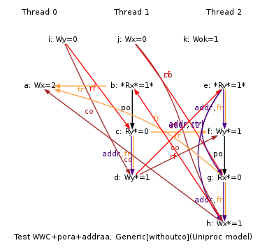

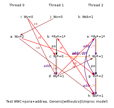

Test WWC+pora+addraa
Executions for behaviour: "1:r1=1 ; 2:r1=1 ; ok=1 ; x=1"
Executions for behaviour: "1:r1=1 ; 2:r1=1 ; ok=1 ; x=2"
PPC WWC+pora+addraa
"RfePR PodRWRA RfeAA DpAddrdWAA WseAP"
Cycle=RfeAA DpAddrdWAA WseAP RfePR PodRWRA
Prefetch=0:x=F,2:x=W
Com=Rf Rf Ws
Orig=RfePR PodRWRA RfeAA DpAddrdWAA WseAP
{ ok=1;
0:r2=x;
1:r2=x; 1:r4=y; 1:r6=ok;
2:r2=y; 2:r5=x; 2:r7=ok;
 P0           | P1               | P2               ;
 li r1,2      | lwarx r1,r0,r2   | lwarx r1,r0,r2   ;
 stw r1,0(r2) | li r3,1          | stwcx. r1,r0,r2  ;
              | lwarx %sta,r0,r4 | bne  Fail2       ;
              | stwcx. r3,r0,r4  | xor r3,r1,r1     ;
              | bne  Fail1       | li r4,1          ;
              | b   Exit1        | lwarx %sta,r3,r5 ;
              | Fail1:           | stwcx. r4,r3,r5  ;
              | li r5,0          | bne  Fail2       ;
              | stw r5,0(r6)     | b   Exit2        ;
              | Exit1:           | Fail2:           ;
              |                  | li r6,0          ;
              |                  | stw r6,0(r7)     ;
              |                  | Exit2:           ;
Observed
    1:r1=1; 2:r1=1; ok=1; x=1;
and 1:r1=1; 2:r1=1; ok=1; x=2;
