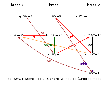

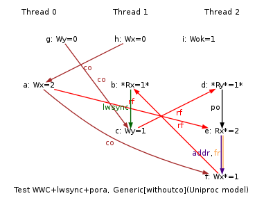

Test WWC+lwsync+pora
Executions for behaviour: "1:r1=1 ; 2:r1=1 ; ok=1 ; x=1"
Executions for behaviour: "1:r1=1 ; 2:r1=1 ; ok=1 ; x=2"
Executions for behaviour: "1:r1=2 ; 2:r1=1 ; ok=1 ; x=2"
PPC WWC+lwsync+pora
"Rfe LwSyncdRW RfePR PodRWRA WseAP"
Cycle=Rfe LwSyncdRW RfePR PodRWRA WseAP
Prefetch=0:x=F,2:x=W
Com=Rf Rf Ws
Orig=Rfe LwSyncdRW RfePR PodRWRA WseAP
{ ok=1;
0:r2=x;
1:r2=x; 1:r4=y;
2:r2=y; 2:r4=x; 2:r6=ok;
 P0           | P1           | P2               ;
 li r1,2      | lwz r1,0(r2) | lwarx r1,r0,r2   ;
 stw r1,0(r2) | lwsync       | li r3,1          ;
              | li r3,1      | lwarx %sta,r0,r4 ;
              | stw r3,0(r4) | stwcx. r3,r0,r4  ;
              |              | bne  Fail2       ;
              |              | b   Exit2        ;
              |              | Fail2:           ;
              |              | li r5,0          ;
              |              | stw r5,0(r6)     ;
              |              | Exit2:           ;
Observed
    1:r1=1; 2:r1=1; ok=1; x=1;
and 1:r1=1; 2:r1=1; ok=1; x=2;
and 1:r1=2; 2:r1=1; ok=1; x=2;
