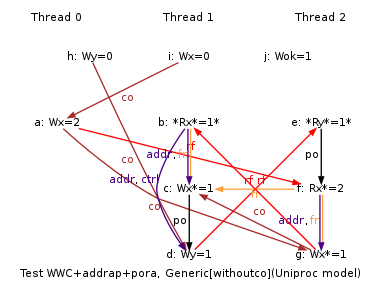

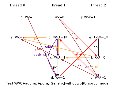

Test WWC+addrap+pora
Executions for behaviour: "1:r1=1 ; 2:r1=1 ; ok=1 ; x=1"
Executions for behaviour: "1:r1=1 ; 2:r1=1 ; ok=1 ; x=2"
PPC WWC+addrap+pora
"RfePA DpAddrdWAP RfePR PodRWRA WseAP"
Cycle=RfePA DpAddrdWAP RfePR PodRWRA WseAP
Prefetch=0:x=F,2:x=W
Com=Rf Rf Ws
Orig=RfePA DpAddrdWAP RfePR PodRWRA WseAP

 P0           | P1              | P2               ;
 li r1,2      | lwarx r1,r0,r2  | lwarx r1,r0,r2   ;
 stw r1,0(r2) | stwcx. r1,r0,r2 | li r3,1          ;
              | bne  Fail1      | lwarx %sta,r0,r4 ;
              | xor r3,r1,r1    | stwcx. r3,r0,r4  ;
              | li r4,1         | bne  Fail2       ;
              | stwx r4,r3,r5   | b   Exit2        ;
              | b   Exit1       | Fail2:           ;
              | Fail1:          | li r5,0          ;
              | li r6,0         | stw r5,0(r6)     ;
              | stw r6,0(r7)    | Exit2:           ;
              | Exit1:          |                  ;
Observed
    1:r1=1; 2:r1=1; ok=1; x=1;
and 1:r1=1; 2:r1=1; ok=1; x=2;
