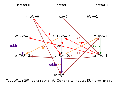

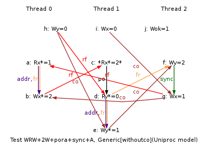

Test WRW+2W+pora+sync+A
Executions for behaviour: "1:r1=1 ; ok=1 ; x=1 ; y=2"
Executions for behaviour: "1:r1=1 ; ok=1 ; x=2 ; y=2"
Executions for behaviour: "1:r1=2 ; ok=1 ; x=2 ; y=2"

Observed
    1:r1=1; ok=1; x=1; y=2;
and 1:r1=1; ok=1; x=2; y=2;
and 1:r1=2; ok=1; x=2; y=2;
