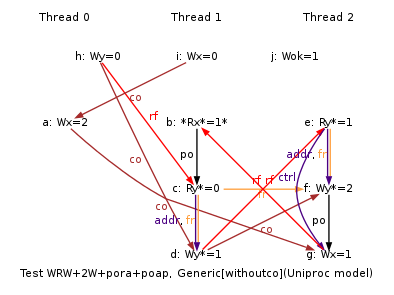

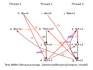

Test WRW+2W+pora+poap
Executions for behaviour: "1:r1=1 ; ok=1 ; x=1 ; y=2"
Executions for behaviour: "1:r1=1 ; ok=1 ; x=2 ; y=2"
PPC WRW+2W+pora+poap
"RfePR PodRWRA WseAA PodWWAP Wse"
Cycle=RfePR PodRWRA WseAA PodWWAP Wse
Prefetch=0:x=F,1:y=W,2:y=F,2:x=W
Com=Rf Ws Ws
Orig=RfePR PodRWRA WseAA PodWWAP Wse
{ ok=1;
0:r2=x;
1:r2=x; 1:r4=y; 1:r6=ok;
2:r2=y; 2:r4=x; 2:r6=ok;
 P0           | P1               | P2               ;
 li r1,2      | lwarx r1,r0,r2   | li r1,2          ;
 stw r1,0(r2) | li r3,1          | lwarx %sta,r0,r2 ;
              | lwarx %sta,r0,r4 | stwcx. r1,r0,r2  ;
              | stwcx. r3,r0,r4  | bne  Fail2       ;
              | bne  Fail1       | li r3,1          ;
              | b   Exit1        | stw r3,0(r4)     ;
              | Fail1:           | b   Exit2        ;
              | li r5,0          | Fail2:           ;
              | stw r5,0(r6)     | li r5,0          ;
              | Exit1:           | stw r5,0(r6)     ;
              |                  | Exit2:           ;
Observed
    1:r1=1; ok=1; x=1; y=2;
and 1:r1=1; ok=1; x=2; y=2;
