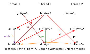

Test WRC+sync+porr+A
Executions for behaviour: "1:r1=1 ; 2:r1=1 ; 2:r3=0 ; ok=1"
PPC WRC+sync+porr+A
"RfeAP SyncdRW RfePR PodRRRR FreRA"
Cycle=RfeAP SyncdRW RfePR PodRRRR FreRA
Prefetch=0:x=T,2:x=T
Com=Rf Rf Fr
Orig=RfeAP SyncdRW RfePR PodRRRR FreRA
{ ok=1;
0:r2=x; 0:r4=ok;
1:r2=x; 1:r4=y;
2:r2=y; 2:r4=x;
 P0               | P1           | P2             ;
 li r1,1          | lwz r1,0(r2) | lwarx r1,r0,r2 ;
 lwarx %sta,r0,r2 | sync         | lwarx r3,r0,r4 ;
 stwcx. r1,r0,r2  | li r3,1      |                ;
 bne  Fail0       | stw r3,0(r4) |                ;
 b   Exit0        |              |                ;
 Fail0:           |              |                ;
 li r3,0          |              |                ;
 stw r3,0(r4)     |              |                ;
 Exit0:           |              |                ;
Observed
    1:r1=1; 2:r1=1; 2:r3=0; ok=1;
