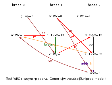

Test WRC+lwsyncrp+pora
Executions for behaviour: "1:r1=1 ; 2:r1=1 ; 2:r3=0 ; ok=0"
Executions for behaviour: "1:r1=1 ; 2:r1=1 ; 2:r3=0 ; ok=1"
PPC WRC+lwsyncrp+pora
"RfePR LwSyncdRWRP RfePR PodRRRA FreAP"
Cycle=RfePR PodRRRA FreAP RfePR LwSyncdRWRP
Prefetch=0:x=T,2:x=T
Com=Rf Rf Fr
Orig=RfePR LwSyncdRWRP RfePR PodRRRA FreAP
{ ok=1;
0:r2=x;
1:r2=x; 1:r4=y;
2:r2=y; 2:r4=x; 2:r6=ok;
 P0           | P1             | P2              ;
 li r1,1      | lwarx r1,r0,r2 | lwarx r1,r0,r2  ;
 stw r1,0(r2) | lwsync         | lwarx r3,r0,r4  ;
              | li r3,1        | stwcx. r3,r0,r4 ;
              | stw r3,0(r4)   | bne  Fail2      ;
              |                | b   Exit2       ;
              |                | Fail2:          ;
              |                | li r5,0         ;
              |                | stw r5,0(r6)    ;
              |                | Exit2:          ;
Observed
    1:r1=1; 2:r1=1; 2:r3=0; ok=0;
and 1:r1=1; 2:r1=1; 2:r3=0; ok=1;
