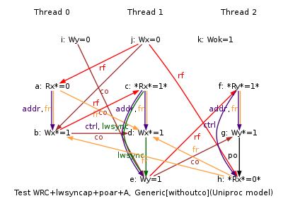

Test WRC+lwsyncap+poar+A
Executions for behaviour: "1:r1=1 ; 2:r1=1 ; 2:r3=0 ; ok=1"
PPC WRC+lwsyncap+poar+A
"RfeAA LwSyncdRWAP RfePA PodRRAR FreRA"
Cycle=RfeAA LwSyncdRWAP RfePA PodRRAR FreRA
Prefetch=0:x=T,2:x=T
Com=Rf Rf Fr
Orig=RfeAA LwSyncdRWAP RfePA PodRRAR FreRA
{ ok=1;
0:r2=x; 0:r4=ok;
1:r2=x; 1:r4=y; 1:r6=ok;
2:r2=y; 2:r4=x; 2:r6=ok;
 P0               | P1              | P2              ;
 li r1,1          | lwarx r1,r0,r2  | lwarx r1,r0,r2  ;
 lwarx %sta,r0,r2 | stwcx. r1,r0,r2 | stwcx. r1,r0,r2 ;
 stwcx. r1,r0,r2  | bne  Fail1      | bne  Fail2      ;
 bne  Fail0       | lwsync          | lwarx r3,r0,r4  ;
 b   Exit0        | li r3,1         | b   Exit2       ;
 Fail0:           | stw r3,0(r4)    | Fail2:          ;
 li r3,0          | b   Exit1       | li r5,0         ;
 stw r3,0(r4)     | Fail1:          | stw r5,0(r6)    ;
 Exit0:           | li r5,0         | Exit2:          ;
                  | stw r5,0(r6)    |                 ;
                  | Exit1:          |                 ;
Observed
    1:r1=1; 2:r1=1; 2:r3=0; ok=1;
