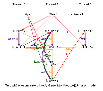

Test WRC+lwsyncaa+ctrlrr+A
Executions for behaviour: "1:r1=1 ; 2:r1=1 ; 2:r3=0 ; ok=1"
PPC WRC+lwsyncaa+ctrlrr+A
"RfeAA LwSyncdRWAA RfeAR DpCtrldRRR FreRA"
Cycle=RfeAA LwSyncdRWAA RfeAR DpCtrldRRR FreRA
Prefetch=0:x=T,2:x=T
Com=Rf Rf Fr
Orig=RfeAA LwSyncdRWAA RfeAR DpCtrldRRR FreRA
{ ok=1;
0:r2=x; 0:r4=ok;
1:r2=x; 1:r4=y; 1:r6=ok;
2:r2=y; 2:r4=x;
 P0               | P1               | P2             ;
 li r1,1          | lwarx r1,r0,r2   | lwarx r1,r0,r2 ;
 lwarx %sta,r0,r2 | stwcx. r1,r0,r2  | cmpw r1,r1     ;
 stwcx. r1,r0,r2  | bne  Fail1       | beq  LC00      ;
 bne  Fail0       | lwsync           | LC00:          ;
 b   Exit0        | li r3,1          | lwarx r3,r0,r4 ;
 Fail0:           | lwarx %sta,r0,r4 |                ;
 li r3,0          | stwcx. r3,r0,r4  |                ;
 stw r3,0(r4)     | bne  Fail1       |                ;
 Exit0:           | b   Exit1        |                ;
                  | Fail1:           |                ;
                  | li r5,0          |                ;
                  | stw r5,0(r6)     |                ;
                  | Exit1:           |                ;
Observed
    1:r1=1; 2:r1=1; 2:r3=0; ok=1;
