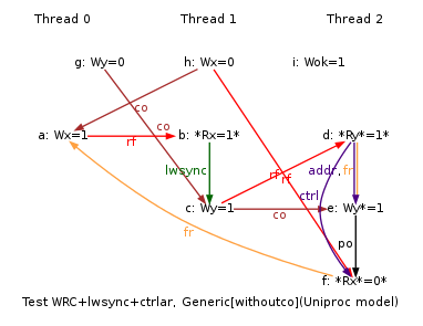

Test WRC+lwsync+ctrlar
Executions for behaviour: "1:r1=1 ; 2:r1=1 ; 2:r3=0 ; ok=1"
PPC WRC+lwsync+ctrlar
"Rfe LwSyncdRW RfePA DpCtrldRAR FreRP"
Cycle=RfePA DpCtrldRAR FreRP Rfe LwSyncdRW
Prefetch=0:x=T,2:x=T
Com=Rf Rf Fr
Orig=Rfe LwSyncdRW RfePA DpCtrldRAR FreRP

 P0           | P1           | P2              ;
 li r1,1      | lwz r1,0(r2) | lwarx r1,r0,r2  ;
 stw r1,0(r2) | lwsync       | stwcx. r1,r0,r2 ;
              | li r3,1      | bne  Fail2      ;
              | stw r3,0(r4) | cmpw r1,r1      ;
              |              | beq  LC00       ;
              |              | LC00:           ;
              |              | lwarx r3,r0,r4  ;
              |              | b   Exit2       ;
              |              | Fail2:          ;
              |              | li r5,0         ;
              |              | stw r5,0(r6)    ;
              |              | Exit2:          ;
Observed
    1:r1=1; 2:r1=1; 2:r3=0; ok=1;
