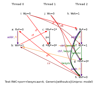

Test RWC+porr+lwsyncaa+A
Executions for behaviour: "1:r1=1 ; 1:r3=0 ; 2:r3=0 ; ok=1"
PPC RWC+porr+lwsyncaa+A
"RfeAR PodRRRR FreRA LwSyncdWRAA FreAA"
Cycle=RfeAR PodRRRR FreRA LwSyncdWRAA FreAA
Prefetch=0:x=T,1:y=T,2:x=T
Com=Rf Fr Fr
Orig=RfeAR PodRRRR FreRA LwSyncdWRAA FreAA
{ ok=1;
0:r2=x; 0:r4=ok;
1:r2=x; 1:r4=y;
2:r2=y; 2:r4=x; 2:r6=ok;
 P0               | P1             | P2               ;
 li r1,1          | lwarx r1,r0,r2 | li r1,1          ;
 lwarx %sta,r0,r2 | lwarx r3,r0,r4 | lwarx %sta,r0,r2 ;
 stwcx. r1,r0,r2  |                | stwcx. r1,r0,r2  ;
 bne  Fail0       |                | bne  Fail2       ;
 b   Exit0        |                | lwsync           ;
 Fail0:           |                | lwarx r3,r0,r4   ;
 li r3,0          |                | stwcx. r3,r0,r4  ;
 stw r3,0(r4)     |                | bne  Fail2       ;
 Exit0:           |                | b   Exit2        ;
                  |                | Fail2:           ;
                  |                | li r5,0          ;
                  |                | stw r5,0(r6)     ;
                  |                | Exit2:           ;
Observed
    1:r1=1; 1:r3=0; 2:r3=0; ok=1;
