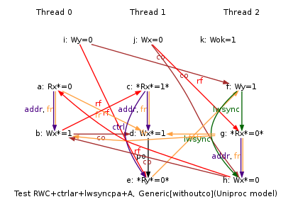

Test RWC+ctrlar+lwsyncpa+A
Executions for behaviour: "1:r1=1 ; 1:r3=0 ; 2:r3=0 ; ok=1"
PPC RWC+ctrlar+lwsyncpa+A
"RfeAA DpCtrldRAR FreRP LwSyncdWRPA FreAA"
Cycle=RfeAA DpCtrldRAR FreRP LwSyncdWRPA FreAA
Prefetch=0:x=T,1:y=T,2:x=T
Com=Rf Fr Fr
Orig=RfeAA DpCtrldRAR FreRP LwSyncdWRPA FreAA
{ ok=1;
0:r2=x; 0:r4=ok;
1:r2=x; 1:r4=y; 1:r6=ok;
2:r2=y; 2:r4=x; 2:r6=ok;
 P0               | P1              | P2              ;
 li r1,1          | lwarx r1,r0,r2  | li r1,1         ;
 lwarx %sta,r0,r2 | stwcx. r1,r0,r2 | stw r1,0(r2)    ;
 stwcx. r1,r0,r2  | bne  Fail1      | lwsync          ;
 bne  Fail0       | cmpw r1,r1      | lwarx r3,r0,r4  ;
 b   Exit0        | beq  LC00       | stwcx. r3,r0,r4 ;
 Fail0:           | LC00:           | bne  Fail2      ;
 li r3,0          | lwarx r3,r0,r4  | b   Exit2       ;
 stw r3,0(r4)     | b   Exit1       | Fail2:          ;
 Exit0:           | Fail1:          | li r5,0         ;
                  | li r5,0         | stw r5,0(r6)    ;
                  | stw r5,0(r6)    | Exit2:          ;
                  | Exit1:          |                 ;
Observed
    1:r1=1; 1:r3=0; 2:r3=0; ok=1;
