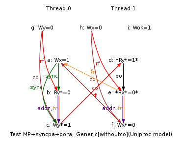

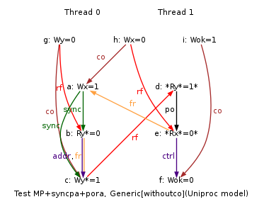

Test MP+syncpa+pora
Executions for behaviour: "1:r1=1 ; 1:r3=0 ; ok=0"
Executions for behaviour: "1:r1=1 ; 1:r3=0 ; ok=1"

Observed
    1:r1=1; 1:r3=0; ok=0;
and 1:r1=1; 1:r3=0; ok=1;
