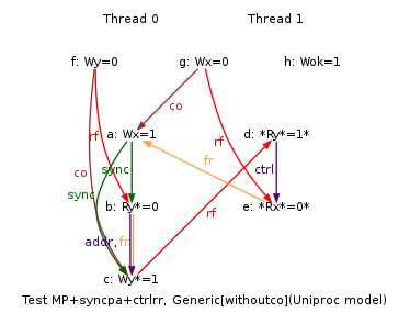

Test MP+syncpa+ctrlrr
Executions for behaviour: "1:r1=1 ; 1:r3=0 ; ok=1"
PPC MP+syncpa+ctrlrr
"SyncdWWPA RfeAR DpCtrldRRR FreRP"
Cycle=RfeAR DpCtrldRRR FreRP SyncdWWPA
Prefetch=1:x=T
Com=Rf Fr
Orig=SyncdWWPA RfeAR DpCtrldRRR FreRP
