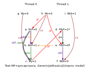

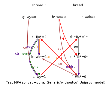

Test MP+syncap+pora
Executions for behaviour: "1:r1=1 ; 1:r3=0 ; ok=0"
Executions for behaviour: "1:r1=1 ; 1:r3=0 ; ok=1"
PPC MP+syncap+pora
"SyncdWWAP RfePR PodRRRA FreAA"
Cycle=RfePR PodRRRA FreAA SyncdWWAP
Prefetch=1:x=T
Com=Rf Fr
Orig=SyncdWWAP RfePR PodRRRA FreAA
{ ok=1;
0:r2=x; 0:r4=y; 0:r6=ok;
1:r2=y; 1:r4=x; 1:r6=ok;
 P0               | P1              ;
 li r1,1          | lwarx r1,r0,r2  ;
 lwarx %sta,r0,r2 | lwarx r3,r0,r4  ;
 stwcx. r1,r0,r2  | stwcx. r3,r0,r4 ;
 bne  Fail0       | bne  Fail1      ;
 sync             | b   Exit1       ;
 li r3,1          | Fail1:          ;
 stw r3,0(r4)     | li r5,0         ;
 b   Exit0        | stw r5,0(r6)    ;
 Fail0:           | Exit1:          ;
 li r5,0          |                 ;
 stw r5,0(r6)     |                 ;
 Exit0:           |                 ;
Observed
    1:r1=1; 1:r3=0; ok=0;
and 1:r1=1; 1:r3=0; ok=1;
