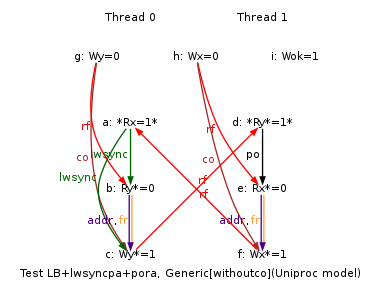

Test LB+lwsyncpa+pora
Executions for behaviour: "0:r1=1 ; 1:r1=1 ; ok=1"
PPC LB+lwsyncpa+pora
"LwSyncdRWPA RfeAR PodRWRA RfeAP"
Cycle=RfeAP LwSyncdRWPA RfeAR PodRWRA
Prefetch=
Com=Rf Rf
Orig=LwSyncdRWPA RfeAR PodRWRA RfeAP
{ ok=1;
0:r2=x; 0:r4=y; 0:r6=ok;
1:r2=y; 1:r4=x; 1:r6=ok;
 P0               | P1               ;
 lwz r1,0(r2)     | lwarx r1,r0,r2   ;
 lwsync           | li r3,1          ;
 li r3,1          | lwarx %sta,r0,r4 ;
 lwarx %sta,r0,r4 | stwcx. r3,r0,r4  ;
 stwcx. r3,r0,r4  | bne  Fail1       ;
 bne  Fail0       | b   Exit1        ;
 b   Exit0        | Fail1:           ;
 Fail0:           | li r5,0          ;
 li r5,0          | stw r5,0(r6)     ;
 stw r5,0(r6)     | Exit1:           ;
 Exit0:           |                  ;
Observed
    0:r1=1; 1:r1=1; ok=1;
