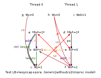

Test LB+lwsyncap+pora
Executions for behaviour: "0:r1=1 ; 1:r1=1 ; ok=1"
PPC LB+lwsyncap+pora
"LwSyncdRWAP RfePR PodRWRA RfeAA"
Cycle=RfeAA LwSyncdRWAP RfePR PodRWRA
Prefetch=
Com=Rf Rf
Orig=LwSyncdRWAP RfePR PodRWRA RfeAA
{ ok=1;
0:r2=x; 0:r4=y; 0:r6=ok;
1:r2=y; 1:r4=x; 1:r6=ok;
 P0              | P1               ;
 lwarx r1,r0,r2  | lwarx r1,r0,r2   ;
 stwcx. r1,r0,r2 | li r3,1          ;
 bne  Fail0      | lwarx %sta,r0,r4 ;
 lwsync          | stwcx. r3,r0,r4  ;
 li r3,1         | bne  Fail1       ;
 stw r3,0(r4)    | b   Exit1        ;
 b   Exit0       | Fail1:           ;
 Fail0:          | li r5,0          ;
 li r5,0         | stw r5,0(r6)     ;
 stw r5,0(r6)    | Exit1:           ;
 Exit0:          |                  ;
Observed
    0:r1=1; 1:r1=1; ok=1;
