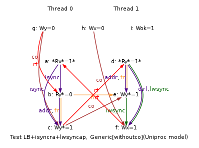

Test LB+isyncra+lwsyncap
Executions for behaviour: "0:r1=1 ; 1:r1=1 ; ok=1"
PPC LB+isyncra+lwsyncap
"ISyncdRWRA RfeAA LwSyncdRWAP RfePR"
Cycle=RfeAA LwSyncdRWAP RfePR ISyncdRWRA
Prefetch=
Com=Rf Rf
Orig=ISyncdRWRA RfeAA LwSyncdRWAP RfePR
{ ok=1;
0:r2=x; 0:r4=y; 0:r6=ok;
1:r2=y; 1:r4=x; 1:r6=ok;
 P0               | P1              ;
 lwarx r1,r0,r2   | lwarx r1,r0,r2  ;
 isync            | stwcx. r1,r0,r2 ;
 li r3,1          | bne  Fail1      ;
 lwarx %sta,r0,r4 | lwsync          ;
 stwcx. r3,r0,r4  | li r3,1         ;
 bne  Fail0       | stw r3,0(r4)    ;
 b   Exit0        | b   Exit1       ;
 Fail0:           | Fail1:          ;
 li r5,0          | li r5,0         ;
 stw r5,0(r6)     | stw r5,0(r6)    ;
 Exit0:           | Exit1:          ;
Observed
    0:r1=1; 1:r1=1; ok=1;
