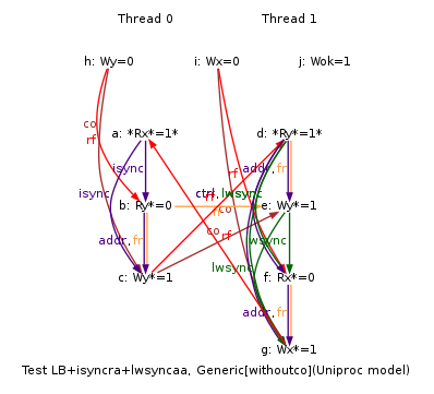

Test LB+isyncra+lwsyncaa
Executions for behaviour: "0:r1=1 ; 1:r1=1 ; ok=1"
PPC LB+isyncra+lwsyncaa
"ISyncdRWRA RfeAA LwSyncdRWAA RfeAR"
Cycle=RfeAA LwSyncdRWAA RfeAR ISyncdRWRA
Prefetch=
Com=Rf Rf
Orig=ISyncdRWRA RfeAA LwSyncdRWAA RfeAR
{ ok=1;
0:r2=x; 0:r4=y; 0:r6=ok;
1:r2=y; 1:r4=x; 1:r6=ok;
 P0               | P1               ;
 lwarx r1,r0,r2   | lwarx r1,r0,r2   ;
 isync            | stwcx. r1,r0,r2  ;
 li r3,1          | bne  Fail1       ;
 lwarx %sta,r0,r4 | lwsync           ;
 stwcx. r3,r0,r4  | li r3,1          ;
 bne  Fail0       | lwarx %sta,r0,r4 ;
 b   Exit0        | stwcx. r3,r0,r4  ;
 Fail0:           | bne  Fail1       ;
 li r5,0          | b   Exit1        ;
 stw r5,0(r6)     | Fail1:           ;
 Exit0:           | li r5,0          ;
                  | stw r5,0(r6)     ;
                  | Exit1:           ;
Observed
    0:r1=1; 1:r1=1; ok=1;
