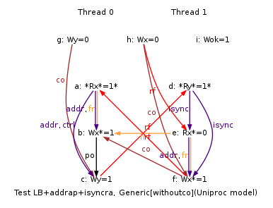

Test LB+addrap+isyncra
Executions for behaviour: "0:r1=1 ; 1:r1=1 ; ok=1"
PPC LB+addrap+isyncra
"DpAddrdWAP RfePR ISyncdRWRA RfeAA"
Cycle=RfeAA DpAddrdWAP RfePR ISyncdRWRA
Prefetch=
Com=Rf Rf
Orig=DpAddrdWAP RfePR ISyncdRWRA RfeAA
{ ok=1;
0:r2=x; 0:r5=y; 0:r7=ok;
1:r2=y; 1:r4=x; 1:r6=ok;
 P0              | P1               ;
 lwarx r1,r0,r2  | lwarx r1,r0,r2   ;
 stwcx. r1,r0,r2 | isync            ;
 bne  Fail0      | li r3,1          ;
 xor r3,r1,r1    | lwarx %sta,r0,r4 ;
 li r4,1         | stwcx. r3,r0,r4  ;
 stwx r4,r3,r5   | bne  Fail1       ;
 b   Exit0       | b   Exit1        ;
 Fail0:          | Fail1:           ;
 li r6,0         | li r5,0          ;
 stw r6,0(r7)    | stw r5,0(r6)     ;
 Exit0:          | Exit1:           ;
Observed
    0:r1=1; 1:r1=1; ok=1;
