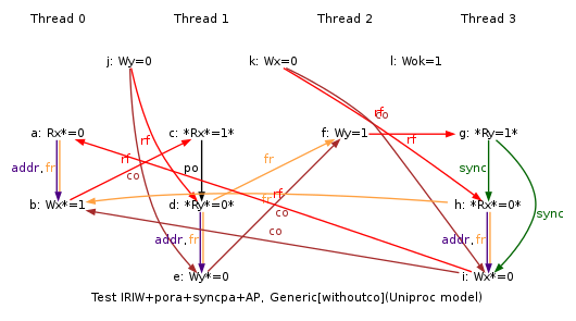

Test IRIW+pora+syncpa+AP
Executions for behaviour: "1:r1=1 ; 1:r3=0 ; 3:r1=1 ; 3:r3=0 ; ok=1"
PPC IRIW+pora+syncpa+AP
"RfeAR PodRRRA FreAP Rfe SyncdRRPA FreAA"
Cycle=RfeAR PodRRRA FreAP Rfe SyncdRRPA FreAA
Prefetch=0:x=T,1:y=T,2:y=T,3:x=T
Com=Rf Fr Rf Fr
Orig=RfeAR PodRRRA FreAP Rfe SyncdRRPA FreAA
{ ok=1;
0:r2=x; 0:r4=ok;
1:r2=x; 1:r4=y; 1:r6=ok;
2:r2=y;
3:r2=y; 3:r4=x; 3:r6=ok;
 P0               | P1              | P2           | P3              ;
 li r1,1          | lwarx r1,r0,r2  | li r1,1      | lwz r1,0(r2)    ;
 lwarx %sta,r0,r2 | lwarx r3,r0,r4  | stw r1,0(r2) | sync            ;
 stwcx. r1,r0,r2  | stwcx. r3,r0,r4 |              | lwarx r3,r0,r4  ;
 bne  Fail0       | bne  Fail1      |              | stwcx. r3,r0,r4 ;
 b   Exit0        | b   Exit1       |              | bne  Fail3      ;
 Fail0:           | Fail1:          |              | b   Exit3       ;
 li r3,0          | li r5,0         |              | Fail3:          ;
 stw r3,0(r4)     | stw r5,0(r6)    |              | li r5,0         ;
 Exit0:           | Exit1:          |              | stw r5,0(r6)    ;
                  |                 |              | Exit3:          ;
Observed
    1:r1=1; 1:r3=0; 3:r1=1; 3:r3=0; ok=1;
