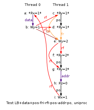

Test LB+data+pos-fri-rfi-pos-addr-po
ARM LB+data+pos-fri-rfi-pos-addr-po
"DpDatadW Rfe PosRR Fri Rfi PosRR DpAddrdR PodRW Rfe"
Cycle=Rfi PosRR DpAddrdR PodRW Rfe DpDatadW Rfe PosRR Fri
Prefetch=0:x=F,0:y=W,1:y=F,1:x=W
Com=Rf Rf
Orig=DpDatadW Rfe PosRR Fri Rfi PosRR DpAddrdR PodRW Rfe
%x0=x; %y0=y;
%y1=y; %z1=z; %x1=x;
 P0           | P1              ;
 LDR R0,[%x0] | LDR R0,[%y1]    ;
 EOR R1,R0,R0 | LDR R1,[%y1]    ;
 ADD R1,R1,#1 | MOV R2,#2       ;
 STR R1,[%y0] | STR R2,[%y1]    ;
              | LDR R3,[%y1]    ;
              | LDR R4,[%y1]    ;
              | EOR R5,R4,R4    ;
              | LDR R6,[R5,%z1] ;
              | MOV R7,#1       ;
              | STR R7,[%x1]    ;
Observed
    0:R0=1; 1:R0=0; 1:R1=1; 1:R3=2; 1:R4=2; y=2;
and 0:R0=1; 1:R0=1; 1:R1=1; 1:R3=2; 1:R4=2; y=2;
