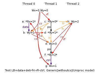

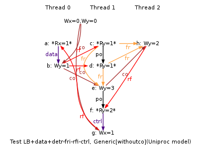

Test LB+data+detr-fri-rfi-ctrl
Executions for behaviour: "0:R0=1 ; 1:R0=0 ; 1:R1=1 ; 1:R3=2 ; y=2"
Executions for behaviour: "0:R0=1 ; 1:R0=1 ; 1:R1=1 ; 1:R3=2 ; y=2"

Observed
    0:R0=1; 1:R0=0; 1:R1=1; 1:R3=2; y=2;
and 0:R0=1; 1:R0=1; 1:R1=1; 1:R3=2; y=2;
