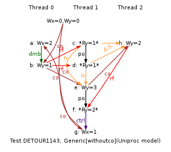

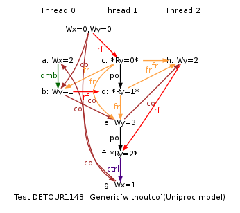

Test DETOUR1143
Executions for behaviour: "1:R0=0 ; 1:R1=1 ; 1:R3=2 ; x=2"
Executions for behaviour: "1:R0=1 ; 1:R1=1 ; 1:R3=2 ; x=2"

Observed
    1:R0=0; 1:R1=1; 1:R3=2; x=2;
and 1:R0=1; 1:R1=1; 1:R3=2; x=2;
