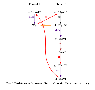

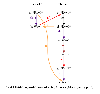

Test LB+data+pos-data-wsi-rfi-ctrl
Executions for behaviour: "0:R0=0 ; 1:R0=1 ; 1:R1=0 ; 1:R4=2 ; z=2"
ARM LB+data+pos-data-wsi-rfi-ctrl
"DpDatadW Rfe PosRR DpDatadW Wsi Rfi DpCtrldW Rfe"
Cycle=Rfi DpCtrldW Rfe DpDatadW Rfe PosRR DpDatadW Wsi
Prefetch=0:x=F,0:y=W,1:y=F,1:x=W
Com=Rf Rf
Orig=DpDatadW Rfe PosRR DpDatadW Wsi Rfi DpCtrldW Rfe
%x0=x; %y0=y;
%y1=y; %z1=z; %x1=x;
 P0           | P1           ;
 LDR R0,[%x0] | LDR R0,[%y1] ;
 EOR R1,R0,R0 | LDR R1,[%y1] ;
 ADD R1,R1,#1 | EOR R2,R1,R1 ;
 STR R1,[%y0] | ADD R2,R2,#1 ;
              | STR R2,[%z1] ;
              | MOV R3,#2    ;
              | STR R3,[%z1] ;
              | LDR R4,[%z1] ;
              | CMP R4,R4    ;
              | BNE LC00     ;
              | LC00:        ;
              | MOV R5,#1    ;
              | STR R5,[%x1] ;
Observed
    0:R0=0; 1:R0=1; 1:R1=0; 1:R4=2; z=2;
