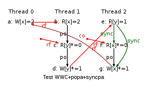

PPC WWC+popa+syncpa
"Rfe PodRWPA RfeAP SyncdRWPA WseAP"
Cycle=RfeAP SyncdRWPA WseAP Rfe PodRWPA
Prefetch=0:x=F,2:x=W
Com=Rf Rf Ws
Orig=Rfe PodRWPA RfeAP SyncdRWPA WseAP
{ ok=1;
0:r2=x;
1:r2=x; 1:r4=y; 1:r6=ok;
2:r2=y; 2:r4=x; 2:r6=ok;
P0 | P1 | P2 ;
li r1,2 | lwz r1,0(r2) | lwz r1,0(r2) ;
stw r1,0(r2) | li r3,1 | sync ;
| lwarx %sta,r0,r4 | li r3,1 ;
| stwcx. r3,r0,r4 | lwarx %sta,r0,r4 ;
| bne Fail1 | stwcx. r3,r0,r4 ;
| b Exit1 | bne Fail2 ;
| Fail1: | b Exit2 ;
| li r5,0 | Fail2: ;
| stw r5,0(r6) | li r5,0 ;
| Exit1: | stw r5,0(r6) ;
| | Exit2: ;
exists
(ok=1 /\ x=2 /\ 1:r1=2 /\ 2:r1=1)
