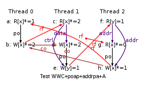

PPC WWC+poap+addrpa+A "RfeAA PodRWAP Rfe DpAddrdWPA WseAA" Cycle=RfeAA PodRWAP Rfe DpAddrdWPA WseAA Prefetch=0:x=F,2:x=W Com=Rf Rf Ws Orig=RfeAA PodRWAP Rfe DpAddrdWPA WseAA { ok=1; 0:r2=x; 0:r4=ok; 1:r2=x; 1:r4=y; 1:r6=ok; 2:r2=y; 2:r5=x; 2:r7=ok; } P0 | P1 | P2 ; li r1,2 | lwarx r1,r0,r2 | lwz r1,0(r2) ; lwarx %sta,r0,r2 | stwcx. r1,r0,r2 | xor r3,r1,r1 ; stwcx. r1,r0,r2 | bne Fail1 | li r4,1 ; bne Fail0 | li r3,1 | lwarx %sta,r3,r5 ; b Exit0 | stw r3,0(r4) | stwcx. r4,r3,r5 ; Fail0: | b Exit1 | bne Fail2 ; li r3,0 | Fail1: | b Exit2 ; stw r3,0(r4) | li r5,0 | Fail2: ; Exit0: | stw r5,0(r6) | li r6,0 ; | Exit1: | stw r6,0(r7) ; | | Exit2: ; exists (ok=1 /\ x=2 /\ 1:r1=2 /\ 2:r1=1)
