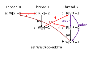

PPC WWC+po+addrra
"Rfe PodRW RfePR DpAddrdWRA WseAP"
Cycle=Rfe PodRW RfePR DpAddrdWRA WseAP
Prefetch=0:x=F,2:x=W
Com=Rf Rf Ws
Orig=Rfe PodRW RfePR DpAddrdWRA WseAP
{ ok=1;
0:r2=x;
1:r2=x; 1:r4=y;
2:r2=y; 2:r5=x; 2:r7=ok;
P0 | P1 | P2 ;
li r1,2 | lwz r1,0(r2) | lwarx r1,r0,r2 ;
stw r1,0(r2) | li r3,1 | xor r3,r1,r1 ;
| stw r3,0(r4) | li r4,1 ;
| | lwarx %sta,r3,r5 ;
| | stwcx. r4,r3,r5 ;
| | bne Fail2 ;
| | b Exit2 ;
| | Fail2: ;
| | li r6,0 ;
| | stw r6,0(r7) ;
| | Exit2: ;
exists
(ok=1 /\ x=2 /\ 1:r1=2 /\ 2:r1=1)
