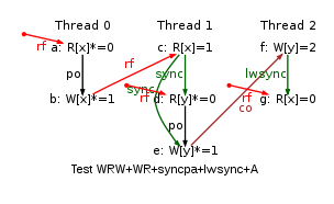

PPC WRW+WR+syncpa+lwsync+A "RfeAP SyncdRWPA WseAP LwSyncdWR FrePA" Cycle=RfeAP SyncdRWPA WseAP LwSyncdWR FrePA Prefetch=0:x=T,1:y=W,2:y=F,2:x=T Com=Rf Ws Fr Orig=RfeAP SyncdRWPA WseAP LwSyncdWR FrePA { ok=1; 0:r2=x; 0:r4=ok; 1:r2=x; 1:r4=y; 1:r6=ok; 2:r2=y; 2:r4=x; } P0 | P1 | P2 ; li r1,1 | lwz r1,0(r2) | li r1,2 ; lwarx %sta,r0,r2 | sync | stw r1,0(r2) ; stwcx. r1,r0,r2 | li r3,1 | lwsync ; bne Fail0 | lwarx %sta,r0,r4 | lwz r3,0(r4) ; b Exit0 | stwcx. r3,r0,r4 | ; Fail0: | bne Fail1 | ; li r3,0 | b Exit1 | ; stw r3,0(r4) | Fail1: | ; Exit0: | li r5,0 | ; | stw r5,0(r6) | ; | Exit1: | ; exists (ok=1 /\ y=2 /\ 1:r1=1 /\ 2:r3=0)
