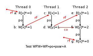

PPC WRW+WR+po+poar+A
"RfeAP PodRW WsePA PodWRAR FreRA"
Cycle=RfeAP PodRW WsePA PodWRAR FreRA
Prefetch=0:x=T,1:y=W,2:y=F,2:x=T
Com=Rf Ws Fr
Orig=RfeAP PodRW WsePA PodWRAR FreRA
{ ok=1;
0:r2=x; 0:r4=ok;
1:r2=x; 1:r4=y;
2:r2=y; 2:r4=x; 2:r6=ok;
P0 | P1 | P2 ;
li r1,1 | lwz r1,0(r2) | li r1,2 ;
lwarx %sta,r0,r2 | li r3,1 | lwarx %sta,r0,r2 ;
stwcx. r1,r0,r2 | stw r3,0(r4) | stwcx. r1,r0,r2 ;
bne Fail0 | | bne Fail2 ;
b Exit0 | | lwarx r3,r0,r4 ;
Fail0: | | b Exit2 ;
li r3,0 | | Fail2: ;
stw r3,0(r4) | | li r5,0 ;
Exit0: | | stw r5,0(r6) ;
| | Exit2: ;
exists
(ok=1 /\ y=2 /\ 1:r1=1 /\ 2:r3=0)
