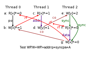

PPC WRW+WR+addrrp+syncpa+A
"RfeAR DpAddrdWRP Wse SyncdWRPA FreAA"
Cycle=RfeAR DpAddrdWRP Wse SyncdWRPA FreAA
Prefetch=0:x=T,1:y=W,2:y=F,2:x=T
Com=Rf Ws Fr
Orig=RfeAR DpAddrdWRP Wse SyncdWRPA FreAA
{ ok=1;
0:r2=x; 0:r4=ok;
1:r2=x; 1:r5=y;
2:r2=y; 2:r4=x; 2:r6=ok;
P0 | P1 | P2 ;
li r1,1 | lwarx r1,r0,r2 | li r1,2 ;
lwarx %sta,r0,r2 | xor r3,r1,r1 | stw r1,0(r2) ;
stwcx. r1,r0,r2 | li r4,1 | sync ;
bne Fail0 | stwx r4,r3,r5 | lwarx r3,r0,r4 ;
b Exit0 | | stwcx. r3,r0,r4 ;
Fail0: | | bne Fail2 ;
li r3,0 | | b Exit2 ;
stw r3,0(r4) | | Fail2: ;
Exit0: | | li r5,0 ;
| | stw r5,0(r6) ;
| | Exit2: ;
exists
(ok=1 /\ y=2 /\ 1:r1=1 /\ 2:r3=0)
