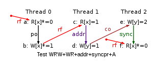

PPC WRW+WR+addr+syncpr+A
"RfeAP DpAddrdW Wse SyncdWRPR FreRA"
Cycle=RfeAP DpAddrdW Wse SyncdWRPR FreRA
Prefetch=0:x=T,1:y=W,2:y=F,2:x=T
Com=Rf Ws Fr
Orig=RfeAP DpAddrdW Wse SyncdWRPR FreRA

P0 | P1 | P2 ;
li r1,1 | lwz r1,0(r2) | li r1,2 ;
lwarx %sta,r0,r2 | xor r3,r1,r1 | stw r1,0(r2) ;
stwcx. r1,r0,r2 | li r4,1 | sync ;
bne Fail0 | stwx r4,r3,r5 | lwarx r3,r0,r4 ;
b Exit0 | | ;
Fail0: | | ;
li r3,0 | | ;
stw r3,0(r4) | | ;
Exit0: | | ;
exists
(ok=1 /\ y=2 /\ 1:r1=1 /\ 2:r3=0)
