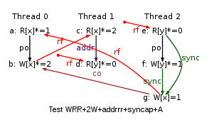

PPC WRR+2W+addrrr+syncap+A
"RfeAR DpAddrdRRR FreRA SyncdWWAP WsePA"
Cycle=RfeAR DpAddrdRRR FreRA SyncdWWAP WsePA
Prefetch=0:x=F,1:y=T,2:x=W
Com=Rf Fr Ws
Orig=RfeAR DpAddrdRRR FreRA SyncdWWAP WsePA
{ ok=1;
0:r2=x; 0:r4=ok;
1:r2=x; 1:r5=y;
2:r2=y; 2:r4=x; 2:r6=ok;
P0 | P1 | P2 ;
li r1,2 | lwarx r1,r0,r2 | li r1,1 ;
lwarx %sta,r0,r2 | xor r3,r1,r1 | lwarx %sta,r0,r2 ;
stwcx. r1,r0,r2 | lwarx r4,r3,r5 | stwcx. r1,r0,r2 ;
bne Fail0 | | bne Fail2 ;
b Exit0 | | sync ;
Fail0: | | li r3,1 ;
li r3,0 | | stw r3,0(r4) ;
stw r3,0(r4) | | b Exit2 ;
Exit0: | | Fail2: ;
| | li r5,0 ;
| | stw r5,0(r6) ;
| | Exit2: ;
exists
(ok=1 /\ x=2 /\ 1:r1=2 /\ 1:r4=0)
