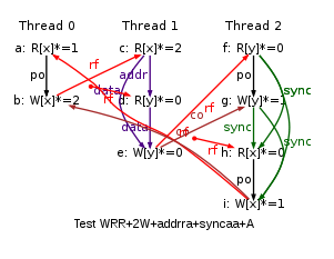

PPC WRR+2W+addrra+syncaa+A
"RfeAR DpAddrdRRA FreAA SyncdWWAA WseAA"
Cycle=RfeAR DpAddrdRRA FreAA SyncdWWAA WseAA
Prefetch=0:x=F,1:y=T,2:x=W
Com=Rf Fr Ws
Orig=RfeAR DpAddrdRRA FreAA SyncdWWAA WseAA
{ ok=1;
0:r2=x; 0:r4=ok;
1:r2=x; 1:r5=y; 1:r7=ok;
2:r2=y; 2:r4=x; 2:r6=ok;
 P0               | P1              | P2               ;
 li r1,2          | lwarx r1,r0,r2  | li r1,1          ;
 lwarx %sta,r0,r2 | xor r3,r1,r1    | lwarx %sta,r0,r2 ;
 stwcx. r1,r0,r2  | lwarx r4,r3,r5  | stwcx. r1,r0,r2  ;
 bne  Fail0       | stwcx. r4,r3,r5 | bne  Fail2       ;
 b   Exit0        | bne  Fail1      | sync             ;
 Fail0:           | b   Exit1       | li r3,1          ;
 li r3,0          | Fail1:          | lwarx %sta,r0,r4 ;
 stw r3,0(r4)     | li r6,0         | stwcx. r3,r0,r4  ;
 Exit0:           | stw r6,0(r7)    | bne  Fail2       ;
                  | Exit1:          | b   Exit2        ;
                  |                 | Fail2:           ;
                  |                 | li r5,0          ;
                  |                 | stw r5,0(r6)     ;
                  |                 | Exit2:           ;
exists
(ok=1 /\ x=2 /\ 1:r1=2 /\ 1:r4=0)
