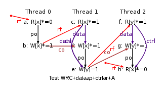

PPC WRC+dataap+ctrlar+A
"RfeAA DpDatadWAP RfePA DpCtrldRAR FreRA"
Cycle=RfeAA DpDatadWAP RfePA DpCtrldRAR FreRA
Prefetch=0:x=T,2:x=T
Com=Rf Rf Fr
Orig=RfeAA DpDatadWAP RfePA DpCtrldRAR FreRA
{ ok=1;
0:r2=x; 0:r4=ok;
1:r2=x; 1:r4=y; 1:r6=ok;
2:r2=y; 2:r4=x; 2:r6=ok;
P0 | P1 | P2 ;
li r1,1 | lwarx r1,r0,r2 | lwarx r1,r0,r2 ;
lwarx %sta,r0,r2 | stwcx. r1,r0,r2 | stwcx. r1,r0,r2 ;
stwcx. r1,r0,r2 | bne Fail1 | bne Fail2 ;
bne Fail0 | xor r3,r1,r1 | cmpw r1,r1 ;
b Exit0 | addi r3,r3,1 | beq LC00 ;
Fail0: | stw r3,0(r4) | LC00: ;
li r3,0 | b Exit1 | lwarx r3,r0,r4 ;
stw r3,0(r4) | Fail1: | b Exit2 ;
Exit0: | li r5,0 | Fail2: ;
| stw r5,0(r6) | li r5,0 ;
| Exit1: | stw r5,0(r6) ;
| | Exit2: ;
exists
(ok=1 /\ 1:r1=1 /\ 2:r1=1 /\ 2:r3=0)
