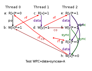

PPC WRC+data+syncaa+A
"RfeAP DpDatadW RfePA SyncdRRAA FreAA"
Cycle=RfeAP DpDatadW RfePA SyncdRRAA FreAA
Prefetch=0:x=T,2:x=T
Com=Rf Rf Fr
Orig=RfeAP DpDatadW RfePA SyncdRRAA FreAA
{ ok=1;
0:r2=x; 0:r4=ok;
1:r2=x; 1:r4=y;
2:r2=y; 2:r4=x; 2:r6=ok;
P0 | P1 | P2 ;
li r1,1 | lwz r1,0(r2) | lwarx r1,r0,r2 ;
lwarx %sta,r0,r2 | xor r3,r1,r1 | stwcx. r1,r0,r2 ;
stwcx. r1,r0,r2 | addi r3,r3,1 | bne Fail2 ;
bne Fail0 | stw r3,0(r4) | sync ;
b Exit0 | | lwarx r3,r0,r4 ;
Fail0: | | stwcx. r3,r0,r4 ;
li r3,0 | | bne Fail2 ;
stw r3,0(r4) | | b Exit2 ;
Exit0: | | Fail2: ;
| | li r5,0 ;
| | stw r5,0(r6) ;
| | Exit2: ;
exists
(ok=1 /\ 1:r1=1 /\ 2:r1=1 /\ 2:r3=0)
