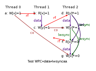

PPC WRC+data+lwsyncaa
"Rfe DpDatadW RfePA LwSyncdRRAA FreAP"
Cycle=RfePA LwSyncdRRAA FreAP Rfe DpDatadW
Prefetch=0:x=T,2:x=T
Com=Rf Rf Fr
Orig=Rfe DpDatadW RfePA LwSyncdRRAA FreAP

exists
(ok=1 /\ 1:r1=1 /\ 2:r1=1 /\ 2:r3=0)
