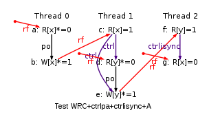

PPC WRC+ctrlpa+ctrlisync+A
"RfeAP DpCtrldWPA RfeAP DpCtrlIsyncdR FrePA"
Cycle=RfeAP DpCtrldWPA RfeAP DpCtrlIsyncdR FrePA
Prefetch=0:x=T,2:x=T
Com=Rf Rf Fr
Orig=RfeAP DpCtrldWPA RfeAP DpCtrlIsyncdR FrePA

exists
(ok=1 /\ 1:r1=1 /\ 2:r1=1 /\ 2:r3=0)
