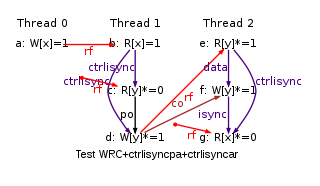

PPC WRC+ctrlisyncpa+ctrlisyncar
"Rfe DpCtrlIsyncdWPA RfeAA DpCtrlIsyncdRAR FreRP"
Cycle=RfeAA DpCtrlIsyncdRAR FreRP Rfe DpCtrlIsyncdWPA
Prefetch=0:x=T,2:x=T
Com=Rf Rf Fr
Orig=Rfe DpCtrlIsyncdWPA RfeAA DpCtrlIsyncdRAR FreRP
