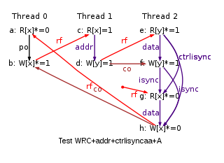

PPC WRC+addr+ctrlisyncaa+A
"RfeAP DpAddrdW RfePA DpCtrlIsyncdRAA FreAA"
Cycle=RfeAP DpAddrdW RfePA DpCtrlIsyncdRAA FreAA
Prefetch=0:x=T,2:x=T
Com=Rf Rf Fr
Orig=RfeAP DpAddrdW RfePA DpCtrlIsyncdRAA FreAA
{ ok=1;
0:r2=x; 0:r4=ok;
1:r2=x; 1:r5=y;
2:r2=y; 2:r4=x; 2:r6=ok;
P0 | P1 | P2 ;
li r1,1 | lwz r1,0(r2) | lwarx r1,r0,r2 ;
lwarx %sta,r0,r2 | xor r3,r1,r1 | stwcx. r1,r0,r2 ;
stwcx. r1,r0,r2 | li r4,1 | bne Fail2 ;
bne Fail0 | stwx r4,r3,r5 | cmpw r1,r1 ;
b Exit0 | | beq LC00 ;
Fail0: | | LC00: ;
li r3,0 | | isync ;
stw r3,0(r4) | | lwarx r3,r0,r4 ;
Exit0: | | stwcx. r3,r0,r4 ;
| | bne Fail2 ;
| | b Exit2 ;
| | Fail2: ;
| | li r5,0 ;
| | stw r5,0(r6) ;
| | Exit2: ;
exists
(ok=1 /\ 1:r1=1 /\ 2:r1=1 /\ 2:r3=0)
