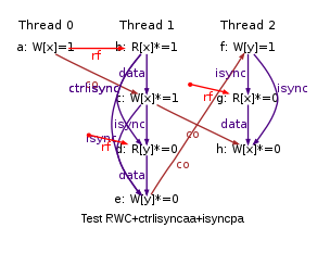

PPC RWC+ctrlisyncaa+isyncpa
"RfePA DpCtrlIsyncdRAA FreAP ISyncdWRPA FreAP"
Cycle=RfePA DpCtrlIsyncdRAA FreAP ISyncdWRPA FreAP
Prefetch=0:x=T,1:y=T,2:x=T
Com=Rf Fr Fr
Orig=RfePA DpCtrlIsyncdRAA FreAP ISyncdWRPA FreAP
