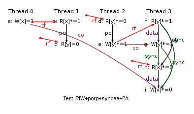

PPC IRIW+porp+syncaa+PA
"RfePR PodRRRP FrePA RfeAA SyncdRRAA FreAP"
Cycle=RfeAA SyncdRRAA FreAP RfePR PodRRRP FrePA
Prefetch=0:x=T,1:y=T,2:y=T,3:x=T
Com=Rf Fr Rf Fr
Orig=RfePR PodRRRP FrePA RfeAA SyncdRRAA FreAP
{ ok=1;
0:r2=x;
1:r2=x; 1:r4=y;
2:r2=y; 2:r4=ok;
3:r2=y; 3:r4=x; 3:r6=ok;
P0 | P1 | P2 | P3 ;
li r1,1 | lwarx r1,r0,r2 | li r1,1 | lwarx r1,r0,r2 ;
stw r1,0(r2) | lwz r3,0(r4) | lwarx %sta,r0,r2 | stwcx. r1,r0,r2 ;
| | stwcx. r1,r0,r2 | bne Fail3 ;
| | bne Fail2 | sync ;
| | b Exit2 | lwarx r3,r0,r4 ;
| | Fail2: | stwcx. r3,r0,r4 ;
| | li r3,0 | bne Fail3 ;
| | stw r3,0(r4) | b Exit3 ;
| | Exit2: | Fail3: ;
| | | li r5,0 ;
| | | stw r5,0(r6) ;
| | | Exit3: ;
exists
(ok=1 /\ 1:r1=1 /\ 1:r3=0 /\ 3:r1=1 /\ 3:r3=0)
